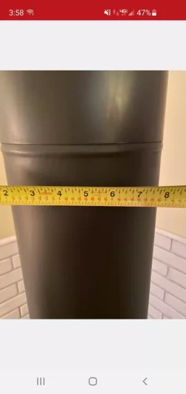

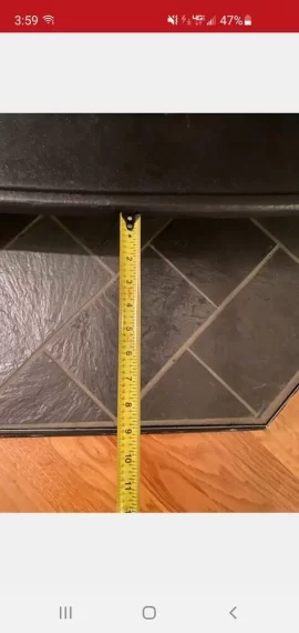

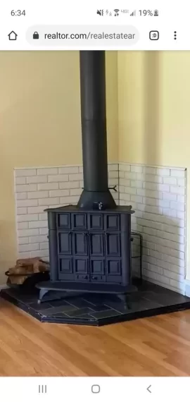

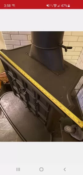

Welcome. That doesn't look like a code legal installation. That stove needs much better wall shielding to be that close to the wall. In order to know what size stove will fit we need to know more about the room and house. Is this room open to the rest of the house or closed off by a door way? How large is it and how tall is the ceiling? Is there a stairwell off the the room to an above floor? I'm surprised the Answer is now selling for $2400, but prices have jumped a lot this year. Have you looked at other brands of stoves?
Thanks for writing. I have no idea when this stove was installed, or by who. My guess is it's an 8' ceiling. It's in the living room, as soon as you walk in the door. It's basically in the center of the home. There is a doorway to the left of the stove tgat leads to the kitchen. There's a small set of stairs off the back of the kitchen that goes to a bedroom in the upstairs. There's no door at the bottom on the stairs. The stove is pointed away from the 2 bedrooms and bathroom on the first floor.

That looks like a fairly short flue system on the stove. I'm guessing about 12'. If so, be careful to select a stove that will work on a shorter stack. Many require 15-16' minimum, but several Canadian made stoves will work on 12-13'.
