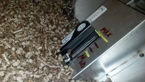

    If I read the post right? Will you be installing the wood stove for Next Year?
    If so.... Then the Pellet stove will need to run this year. Which will give you time to work on it. The best troubleshooting tips have already been noted in this thread. Check gaskets, clear vacuum hose/barb, clean stove, open feed gate, etc, etc.
    If all else fails, then once you get it started, just run it on Low or Med. If the house gets to warm on Med, either lower feed gate or drop to Low. If it gets to cold on low, then go to Med or open feed gate. Once running the only way its really gonna shut down is from lack of feed. Find the line in which that happens? Make a mark on the feed rod and NEVER go below that point. Ever... :)

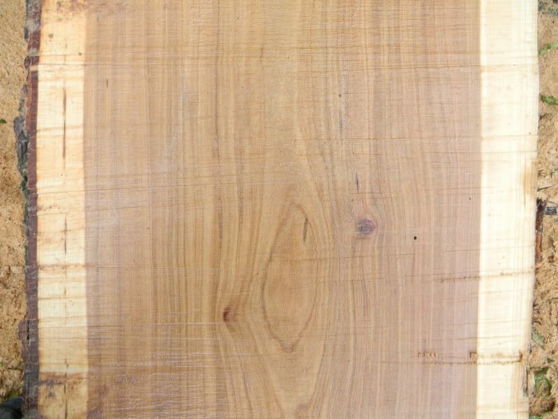

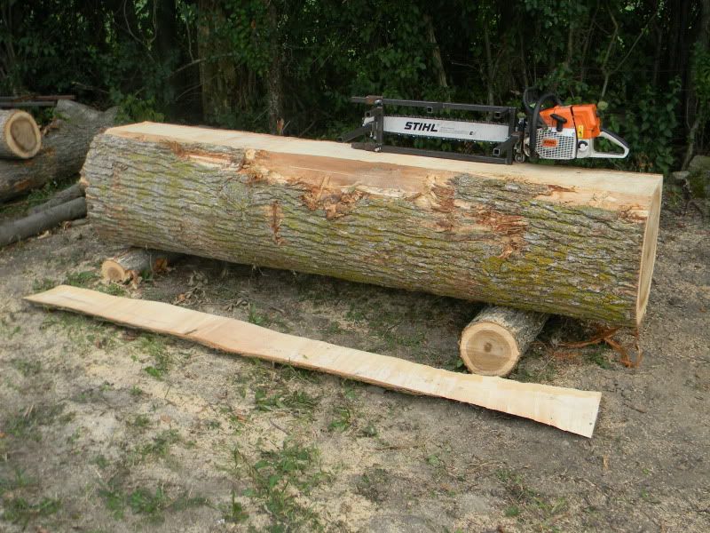

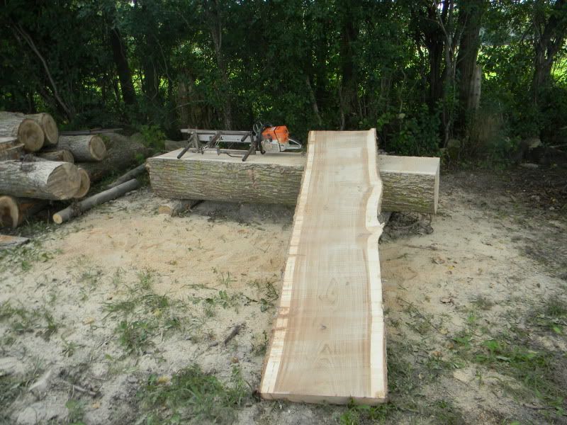

    And maybe some milling with the underpowered 440.. Here's a nice little 31" wide Elm bar top. I am a welder/fabricator and diesel mechanic and heavy equipment mechanic by trade and I build my own chain saw mills and guides.

    Damn I wish you lived closer :)
    I am looking to buy an Alaskan 36" Mill here in the next year or two. Time is all thats stopped me thus far. They dont cost much, but they do take time to run :(
    Thats a beautiful board you have. Are you leaving the bark on? Or squaring it up? Looks great all natural.
