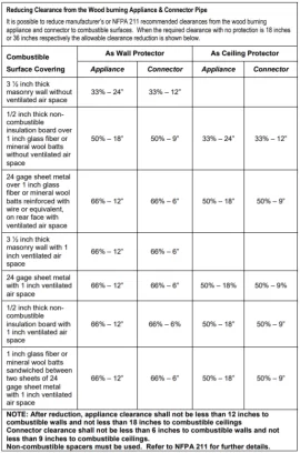

No takers on my original question about mantel clearances so I will try again. I found the below attached NFPA 211 clearances on a stove mfg site. I do not know if the typos (% instead of ") comes from NFPA or the mfg. Anyhow, nowhere is there guidance on clearance to a wood MANTEL. A mantel is not a wall, and I do not think it is a ceiling either. Its wood so its combustible, but I still can't figure it out. It appears as though with proper shielding clearances to a ceiling can be reduced by 50%, but may not be less than 18" I would hope a wood mantel, which is not a ceiling, can be closer than 18". My stove spec is 24" to a mantel, so with shielding I would think 12" (50%). But that is less than 18". But its not a ceiling, so..... There are plenty of threads on this topic and posts with pictures which is helpful, but no answers as to code and NFPA 211. If you dropped a plumb line off the edge of my mantel it would probably overhang 1/3 the depth of my stove.
It is possible that the stove manufacturer did not test a reduced clearance for the mantel so it not listed or advised to reduce the actual clearance in the field.
I imagine that is possible. There seems to be some disconnect in standards however as each manufacturer seems to have specs for alcove clearances, which vary, and then reference NFPA-211 for protected surfaces which are standardized. I guess I can find another stove manufacture with the same alcove clearance that did do mantel testing and just use their data.

Mantels in alcoves are not all that common. The first place to ask is the stove company's tech support. If they are ok with a mantel shield on spacers, ask for it in writing. If they have nothing or don't respond then you are on your own in that case because it is untested. It may be ok with a proper shield, but it depends on the mantel design and shielding. Note that the stovepipe also has clearance requirements too.

My guess is that there is no way they would open themselves to that sort of liability. I did send them the question though. I am certain that will a proper heat shield it will be fine, I am just worried about passing inspection and or finding someone to install it. I do not think an installer will do it without code compliant clearances. There is probably a way around that, but then what? I guess you never have to get it inspected? I am in Oregon.

I did find this. So some company will sell you a product that cuts the clearance in half (just like 211). It’s cheap enough and probably gives you the best chance should anyone question the clearances.
The Mantel Protector attaches to your mantel and allows a clearance reduction from 36″ to 18″ from the top of an unlisted stove, as required by the NFPA 211 requirement.
I just looked at my manual and it says 24” too. No mention of reducing it.

If the installation is to be inspected, then asking the inspector in advance if the heat shield would be acceptable is a good place to start. It should be ok but it's good to verify. An alternative would be to put in a non-combustible mantel.

I would bet your inspector won't even notice. As far as the installer some won't do it without a spec some will sheild it and call that good and others will completely ignore the issue.
