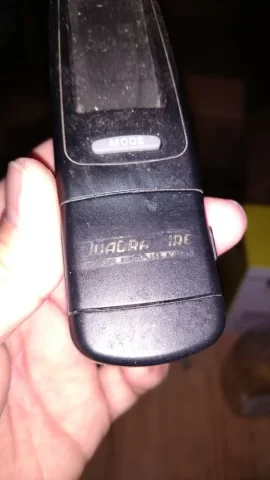

im not sure i understand your comment about stove not having a manual setting. I has a black box that attaches to the back of the stove with a off setting....therm setting....and a on setting. ? Ive mostly used the on setting as the thermostat doesnt seem very effective nor economical on fuel.

Can you post pics of the stove and that box? None of it makes any sense. kap

Nice pics, but not one of the box on the back you talked about. This stove is an older model. It should run off a thermostat, and only have a switch on the back that says low med high. IT runs all 3 motors at the same time. And I would suggest you download a manual from Quads website or some place, so you will understand the stove more, and helps us, help you. kap
this is what stinks about the interenet...things get too mixed up. im not sure what box i spoke of.........? i thought you meant the control box you wanted too see. yes i knew it was an older stove.. box says 2005 so....... im not sure about your comments on the thermostat........the black box is a unit that fastens to the back of the stove.....and has a on and off and therm setting if you want to use the remote control. maybe this was an add on? and yes my stove has three setting....low med and high
that box on the floor does not look like a quadrafire add on. why is it there?

Ya, that is an add on for remote. I just use a tstat on mine. Only reason I can think of, that you lose conv fan on low, is maybe the heat exchanger tubes are too dirty to stay warm enough to trip #1 snap disc, which runs conv. fan, or feed rate is a tad low. I would download a manual as I suggested, so you can understand the operation of your stove, and how to clean it. It will also tell you how to set the flame height, which is using the feed adjusting rod in hopper. As far as the dial on the control box, that is different settings for different stoves. Yours should be on 6. And always, make sure to unplug stove before installing or removing a control box, or you run the risk of toasting it. Just pulling the heat exchanger rods works for short cleans, but you need to remove the heat deflector, to expose the heat exchanger tubes, to do a good cleaning. Also pulling the left and right brick in back, to get piles of ash behind them. Let us know how it goes. kap

Sure is factory...says quadrafire right on it. Crazy none of you have heard or seen this before. It's not that the stove doesnt run the fan on low....it just comes n goes
Like it's on a thermostat. Like mentioned I bypassed the vacuum switch......stove runs now...... but I've run this stove on low for a few seasons and that s the way we prefer it with our set up. And like mentioned. It was professional cleaned thoroughly in the fall before season.
