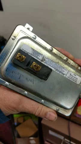

This is orginal switch.....I just noticed some one hand wrote. Orange wire. Red wire by terminals. Does this matter????
Maybe that's the issue ....I never paid attention if they have to be a certain way ?
I was going to call the switch company where I bought the new one and check on warranty?

Shouldn’t matter which wire the switch is just completing a circut. Either the new switch is bad or its the wrong vac setting for it to close

Ok thanks......yeah. Our luck it's bad! Brand new! It's the exact switch that came out of it right down to the part number. We ordered it directly from the manufacturer thinking we did a good thing. Rather than buying aftmarket junk off line. We are calling them now. See if there is a warranty.
Ok we just got off the phone with cleveland controls. Confirmed doesnt matter which wire goes where coming from stove. Told us we could send it back for them to test if we wanted. they highly doubted we got a defective switch...... OR we could disconnect hose from fire pot....suck into that and crimp it tight....to see if the switch did its job. Kind of a crude test...but we will try that.

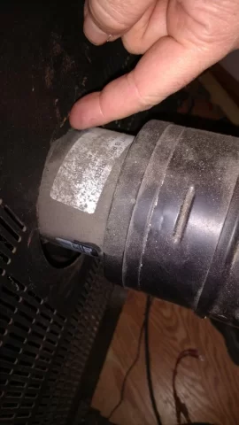

Question....when I cleaned out the rear exhaust pipe that goes into the outlet exhaust up thru the ceiling. .....should it be solid or does it have any wiggle to it.? Didn't seem to be solid..... don't know if thats normal. ? Thanks.

What your pointing to looks like a duravent appliance adapter, it should fit over the exhaust manifold fairly tight with a silicone sealant on the inside. I also use 3 self tapping screws but not everyone does

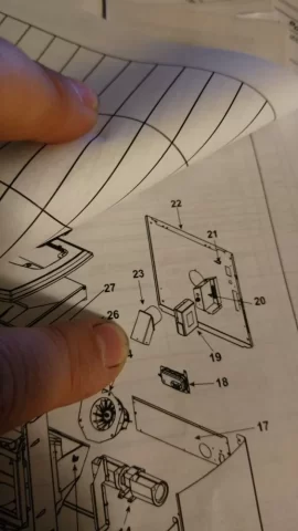

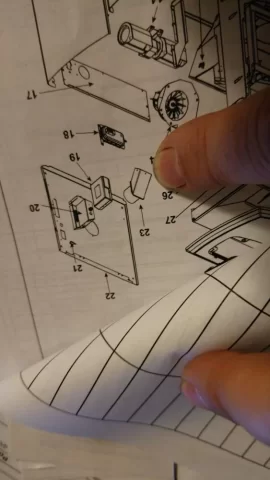

No I'm just pointing at the location of where I speak of.......the piece that the exhaust pipe slides over..... it's the .part of the stove I'm speaking of. It's not super tight. Has a lil play.... didn't know if that was normal. 23 is the part I'm speaking of in the pic below

Ok thats the manifold. Usually they are tight and have sealant around them along with screws or rivets.
Hmmm. Il have to get in there then and look. When I took off pipe. I grabbed it to vaccum it out and it moved. Maybe that s the vacuum problem???
The entire manifold might have movement/flex depending on the stove, they don't have much support except where it connects to the fire box and you have a lot of leverage that far away to move it slightly, my Windsor moves a bit if you reef on it.

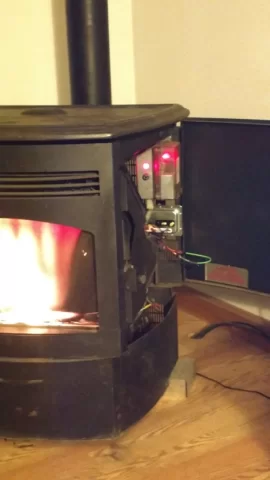

UPDATE.............................so called manufact or vacuum switch and they told me i could preform a quick crude test. disconnect vac hose at fire box and suck the vacumm hose to see if the vac switch is working. sure enough..we did that...and the stove instantly turned on and fired up. Been running for days now...just fine. I dont know if these vac switches need primed or what...but that fixed it!! so far so good................I WANT TO THANK ALL THE FOLKS ON THIS FORUM THAT CHIMED IN AND SENT ME PM'S TRYING TO HELP US............we really appreciate it. Thank you.
