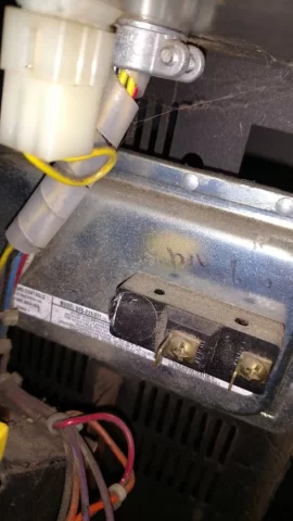

24 hours. After I adjusted the rod in the hopper no issues so far. Now if I could just find that vacuum switch. Can't seem to find the exact type that's in our stove. It's rectangular...not round like I've found. ??
It could have been replaced at some time. They are now round and plastic. It has a rubber hose going from it to the auger tube. You should be able to google an owners manual or a pic of it. kap

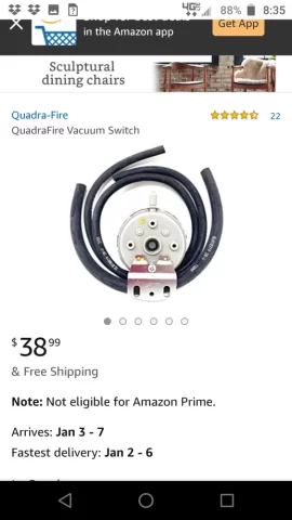

Is there a brand to stick with?. I see a big swing in pricing. And have read people having issues with aftermarket parts these days.
That is the original one. I would pull the vac hose, and blow thru it to make sure it is clear of debris, and then use a stiff pc of wire or paper clip, and poke it thru the nipple on auger tube to make sure it is clear of debris. Then reassemble to see if it still works. I would stick with a quad replacement. As you said, after market has a bad name, and they need to be set to what your stove needs. kap
This ? How do we know if we're getting factory parts though :(
  • [Hearth.com] No fan on low manual setting.
They usually say OEM or after market. Looks like the one I just got for my Santa Fe. kap
