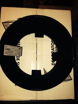

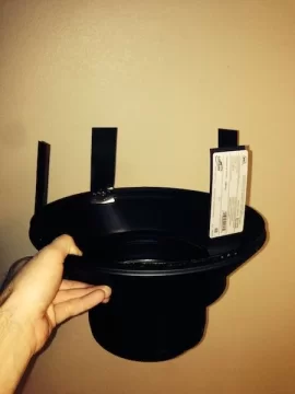

Here are the components that support the selkirk class A. I know I don't need to and probably can't, but If I use a noncombustible structure to create the box that the ceiling support attaches to (the round item with 4 tabs) it will be extra safe. I know I'm grasping at straws and will probably just use lumber as that is what I did with my own install.
Thanks

Frame the support box bigger and fill it in with durarock. 2" bigger will give you 4" clearance.
Your assumption that it will be extra safe is based on your solution being as structurally sound as the solution Selkirk tested. It can be done, but it depends on your skill and aptitude. There are likely other areas in the install were you can gain better safety for the work involved.

This is scary, I worry that the whole dang thing could fall down. The screws would have to run through 2" of durock before biting into lumber. The load of the chimney will be able to bend/twist/pivot the screws. Normally, the screws bite into wood immediately outside of the metal box and the screws are in shear. Much stronger.

This is the same setup that we have. It is designed and tested for fire safety. Just follow directions and ask questions when unsure. The system is designed to be very safe as long as installation follows the book. The main thing you can do to keep things safe is to honor or exceed clearances all the way, don't cut corners, and vacuum clean everything before installing the insulation shield and pipe.

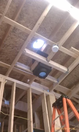

This is weight bearing structure. If you are using engineered brackets to hold the framing lumber you need to use what is specified which is usually nails but sometimes they allow a special screw. The old days of just popping nails into existing framing are gone. You can see in my photo, I used simpson structural hangers. Mine was inspected and I sure don't want the ceiling to fall down.

Existing ceilings are not exempt from proper structural requirements. You're supposed to use the hangers and the hangers work fine with existing ceilings as well. Maybe another topic eh?
