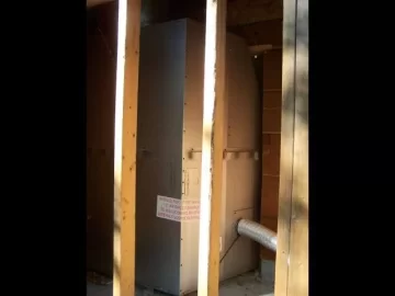

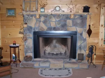

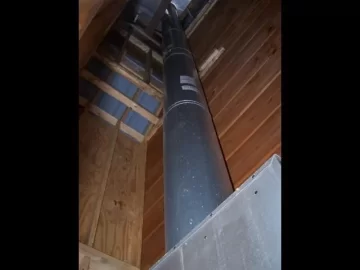

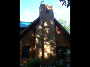

New post. Still haven't nailed down which fireplace to install. I'm replacing a Heatilator ICON 100 prefab. Was down to the Napoleon High Country NZ6000 or the Extrordinair Elite 44. Had to rule out the Napoleon because it requires metal studs above the header and sheet rock up a ways too. Won't work because I have solid wood walls in my log home. So the Extrordinair ($7K installed with chimney system....yikes!) looks like the winner, but I am semi-considering both the Quadrafire 7100 and the Heat N Glo North Star. They're a step down in size (matters) but they look good and seem to be good heat producers. Are they made by the same manufacturer? They look like clones and the specs are almost the same.
Does anyone have any experience with the North Star? Have read some about the Quad, but very little about the North Star.
Thanks.

BTW: Pics are what I have now and plan to replace. Only two seasons old. Want to leave the stone. Wife loves it. I'll have to do some stone work to fill in the voids when the new goes in. That's one reason I wanted the bigger unit. Might not look like it, but the opening is huge. 50 inch wide firebox.
