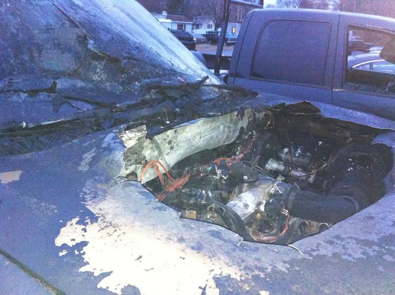

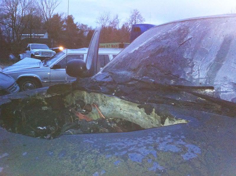

The hood is just vaporized, and check out the stress fractures in the metal from when the water hit it. Wish I had the presence of mind to shoot a video with my phone, but I just stood there gawking, hugging my saw.

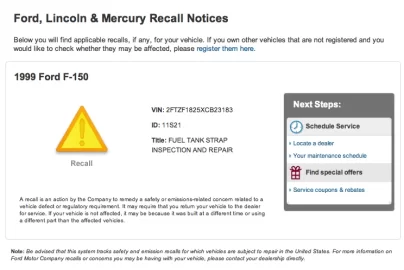

Truck was a '99, bought back in April and used every day until I got sick in June. Then I only used it occasionally. Ford knew enough to send me a recall notice about the gas tank straps back in September, addressed to me. It has to be connected to DMV and the VIN I'd assume. After all, even with a new vehicle there has to be a way to contact second owners about safety issues. Not everybody keeps a truck for the full loan duration, and many are sold through private sales.

Thanks. Looked it up and saw only the recall notice I received, regarding the gas tank straps (this was definitely not the cause of the blaze). Where would I find out about the reputed cruise control problem? This is the first I heard of it here.

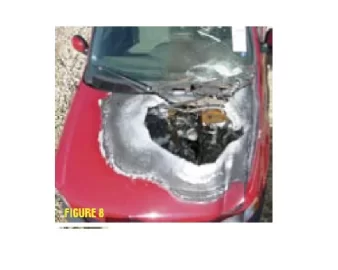

I've emailed you the a report that does an analysis of Ford F150 vehicle fires associated with the cruise control circuit problem. There is also a link to the NHTSA campaign to deal with the issue. My understanding Ford dealt with the problem on your vehicle with recall 05-S28Q.
Look at Figure 8 in the report (attached)...
I'd be curious to compare the images in the report with your wreck.
