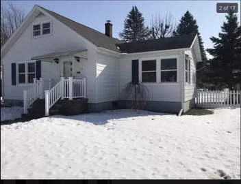

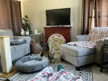

Hi! It would cost 1200 plus to get gas to the house from the road and don’t want propane tank either so wood it is! This living room is small …..I can show a pic of the wall where wood burner would go perhaps….behind my chair is more to this rectangular room that has dining room table and chairs…..Off the room is the kitchen that has 3 stairs to go outside to get wood placed in backyard. And the other door off dining room has a bedroom to the right, one to the left and a tiny bathroom in the middle. Some furniture may end up moved to upstairs room like the fake fireplace and maybe chair/ottoman….not exactly sure. I use a cordless dyson vac often and a steam mop for floors having pets…..there is light carpet covered with a rug but am hard on things and with the dogs and me and kitty it’s all good….am not “fussy” about things. The house pic shows area off to the right that is the LR where stove will go according to chimney guy
C6C751D1-D175-43BD-AA5C-3295ED6DDF3A.jpeg 41CA2647-0F8F-4976-AF21-FA1730A3F238.jpeg
