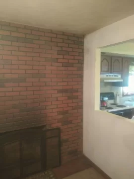

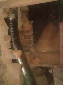

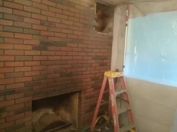

Here is a fun one we are dealing with. Someone came down with a stainless liner then teed over to a clay lined block chimney going the rest of the way to the basement with no cleanout access. Fun

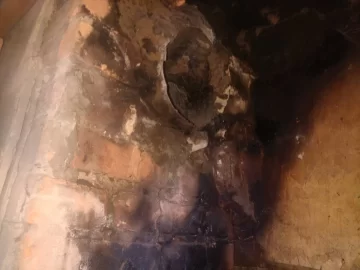

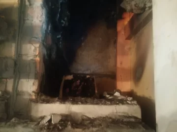

Oh and caped that block chimney off with 2 bock a joint in the middle under a closet floor. Which is where all the charring came from
Ouch. That is a timebomb waiting to ignite. Glad you have been able to get in there and remedy the situation before a catastrophe struck. Did the homeowner smell smoke?
The chimney clogged and dumped oil fumes everywhere

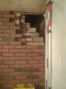

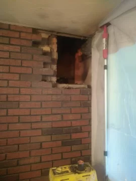

Nothing diy about this they paid a mason 25 years or so ago to have their fireplace that had the furnace run up through it made functional again.

That must have been a hefty bill, but, priceless for the homeowner to have it done right.
Yeah I actually tried to talk her into a power venter or new condensing furnace and abandoning the chimney. But she wanted it fixed. It was definitely the more expensive option
That looks great Bholler, but im with you. I would have just swapped over to a new high effeciency furnace that you can vent into pvc out the side of the wall.
That's what most of the new construction around here does with oil furnaces. Customer got what they wanted and bholler got some work tho so I guess it's a win win!
I really didn't want to do it honestly it was a big pita
