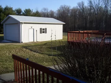

and don'twant to cause any problems. I just have a question. How would you guy's change this building to be able to season fire wood? It is 20x30 and there is a window directly across from the one you can see. I also have a 2 1/2 car attached garage and I live by myself, so I can use this for anything I want to. I would like to hook up a old Hartman stove that came with the house, to help heat the garage when I am working on a car or a wood working project. I would like to be able to put in as many cords I can, once air dried on the outside. I am looking for ideas on how to vent out the moisture from inside the garage. Heck, you guy's know what I talking about. It does have electric and even an old air conditioner!!!!!

Honestly I'd think about adding a lean to whichever side the prevailing wind direction is out of. Leave it out there and bring it into the garage or wherever as you need it. It will take up more room than you may think.
My garage is 28x 28 and ive got a lean to on the west side adn it's constantly got a breeze. I just wish it was bigger so I could leave more outside. As it is I stack my current yr wood inside the garage (3.5- 4 cord )..2 rows down my East and west sides.. It doesn't seem like it's taking up a lot of good useable space but it really is when I have the sld/quad and mower in there and want to get my truck inside.
