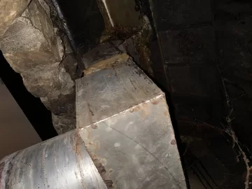

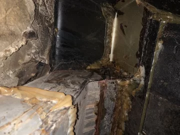

Year and a half...don’t think anyone will mind if I hijack the thread!
So, how sketchy does this look? Previous home owner was a sheet metal worker so I’m guessing he made all of this himself, looks like he just made an adapter to fit in the damper hole (damper is gone) and glued the guts out of it. That’s 8” round coming into the bottom square for reference.

Ugh, that does not look good on several fronts.
For the block off plate make a cardboard template and make your hole a little oversized, you can always wrap another piece of insulation around your liner just below the block off plate to help seal the gaps.
