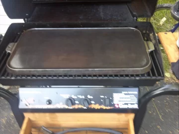

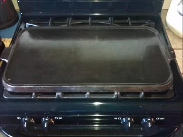

Garage sale find, $30, Griswold #11. I took it out of the lye bath today and finished scrubbing it with steel wool. It was a rusty mess. Now, I'm not sure what to do, because it's too darn big to fit in the oven for a proper seasoning. It's also too big to fit on my gas grill. We have a bigger grill at our weekend place, so hopefully that will work.
Thing weighs about 50 lbs.

Nice skating rink!
Time for a nice outdoor fit pit ? :)
Reactions: Hills Hoard
Yep - a low and slow pit fire with a couple of properly place bricks will get the job done. Just don't get all crazy - it is easy to pull enough coals to overfire cast. That will defeat your purpose.
I've had good luck in the oven at 350-400° for an hour or so. Let it warm up and cool down with the oven. I hope it fits on the grill at the lake. If not, a neighbor up there has a giant stainless job that should work. I guess I'll take my IR thermo just in case.

So, it barely fit on the grill
[Hearth.com] Now, that's a griddle

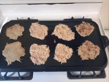

It's just too darn big, though. I have all four burners on, and need another in the middle. Eight potato pancakes, but only the outside four really get cooked. Take them off, then slide the inside four out. Worked great, still cooked a bunch in a short time, and it was sooooper slick.
