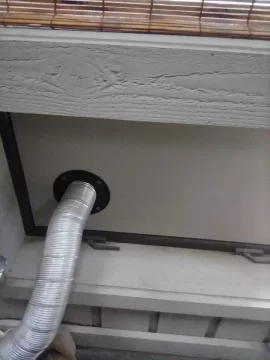

Late to the game here but, this is what I did. The area where the AOK intake goes used to be a crank out window that's close to the floor. I took out the mechanicals but left the frame. The outside is a piece of exterior grade plywood cut to fit in the opening and is stained to match the house. It's a contemporary. The inside, which you see in the picture is a piece of one inch blue Styrofoam insulation painted to match the walls in my sunroom. The screws in the eschuteon (sp) plate are long enough to go through the styro and into the plywood. It works great.

I looked at the pix of what you have and I can see that. Mine came with the kit. There must be something you could fashion, perhaps out of wood, that would look nice. Square piece of wood, two inch hole, route the edges, prime and paint. Done. You could also stain and varnish. Given that its a cold air intake there would be no worries about fire. Good luck.
