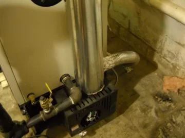

BTW my OAK is working great... I am preheating my air from lost heat from chimney... [Hearth.com] OAK length[Hearth.com] OAK length[Hearth.com] OAK length[Hearth.com] OAK length

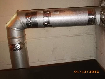

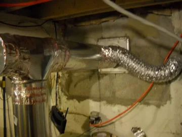

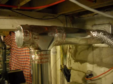

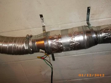

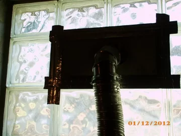

Hey Guys here is what I did. I took the vent window out of my glass block & put a 3" 90degree elbow.
I have a 12ft span & about half way I put in a 4" round fan with 3to4 galv reducers. It does not over pressure the stove. With the stove off & the fan plugged in, I get a low flow coming into the burn pot. I have an Enviro Maxx-M
& it works well for me. If anyone is interested, I can get pictures.

IceGuy4:
Here are the pictures. Ask away with questions. I will try to help

does the duct fan run constantly?
Iceguy4: yes the fan runs constantly. I have it pluged into my surge protector. Here is anothor point, last summer I had my power company put a surge protector on my meter. On the outside pipe I put screen netting to prevent the critters from getting in. Also, with the fan running I get a clean burn & with out it running & the stove above #3setting you can see on the magnehelic gage that there are wide fluctions. This also depends on the type of stove you have. I just feel that a fan is necessary in long runs.
