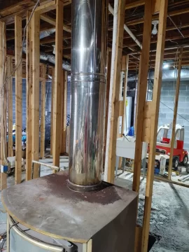

Some pics would help. But yes you may need to destroy the bottom section of chimney
Here is a picture.
[Hearth.com] Odd Situation
How is the rest of the chimney supported?
That is a very good question and one I have to go into the attic to see if I can find out. That is one of my main concerns too! The pipe goes up through a sheet metal cover in the basement and runs up a boxed chase along with a gas fireplace on the first floor through a two-story room so I may need to remove the metal cover in the basement and see if I can see up the chase.
If it is not supported well, is there a way to brace it at the bottom? I really don't care what it looks like because the stove's only purpose is functional, not decorative.
