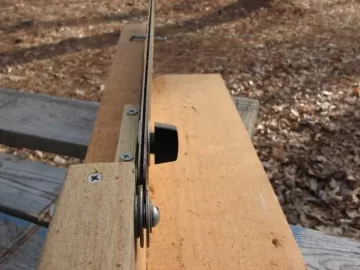

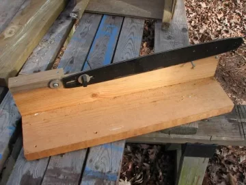

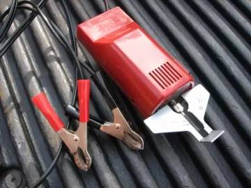

I used this electric chain saw sharpener for five years now and have been very pleased with it.
I can sharpen the chain right on the saw or use this jig i made to sharpen my other chains : )
