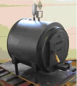

Our first wood boiler (1979/1980) was one like the one pictured and was used as a "Add On" and was originally plumbed in series with our oil boiler .In series it burned 22 cords in the first year. Next it was plumbed in parallel this change dropped its wood consumption by 4 cords , meaning there is a lot of stack loose if you continue to keep your oil boiler warm . But if you want automatic switching between the two it gets more complicated plus expensive.
Operating experience has also shown me that a wood boiler does not function that well when the fire cycles as it is slaved to the house thermostat . Creosote buildup in the smoke pipe and chimney can become a very serious safety concern .
It does not sound like you are planning on using heat storage so if you have a high heat load in the winter months a small gasification boiler may be able to work with some success as a add on , but without storage operating it in series with your oil boiler may give a little more load and slightly longer burn cycles .
If you you really want peace of mind a wood gasification boiler with storage is the only way to go .
Our old Jetstream gasifcation boiler with 1,000 gallons of storage on average burns 4 1/2 cords where the original burned 22 cords .
Best of luck many of us have been where you are !!!!
