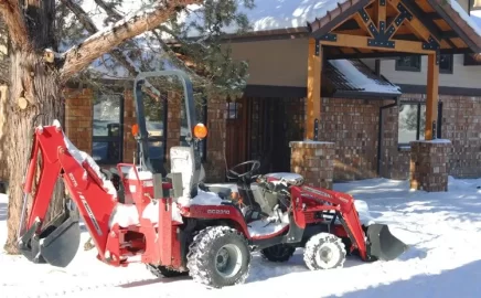

AHH! Should've waited for the pics. I have a little MF GC2310 TLB, and I use the FEL to move snow. It would work better for that if I took off the backhoe (all that weight on the back tends to make me lose steering pushing snow uphill, even with 4WD). Even so, I don't have quite the challenge you do, most of my place is fairly flat. Also, moving snow with a FEL is a bit tedious...lots of scooping, dumping, backing. A rear blade on the 3PH that could be angled would be a nice addition to the FEL, then I could move snow in both directions. I know guys who do that with their tractors to good effect. Rick
is that thing gas powered or deisel? thanks for the photo!

It's a 3 cylinder diesel, ~23 HP. So long as I remember to add fuel conditioner to the tank in advance of the cold weather, it's not a problem getting it to start & run just fine, even in sub-zero temps. If it's sitting there with fuel in it I got the previous summer and I haven't remembered to treat it and run it, then it ain't gonna start. They (the fuel providers) add conditioner to the diesel they sell during the winter, but not during the summer, so us low-volume users need to realize that. So long as I keep that in mind, I'm OK. I learned my lesson, believe me. Rick
Thats a damn fine house you got there Fossil!!!!
You should post some pics of it for all us to admire!
