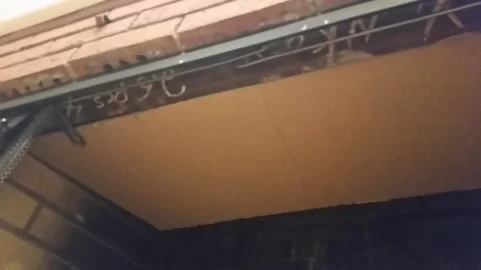

Ok, you've convinced me to add a block off plate.....

[Hearth.com] Ok, you've convinced me to add a block off plate..... Cardboard cutout made.....

Hello mstoelton ........I'm not sure you got the gist of the thread......I AM doing a block off plate.
