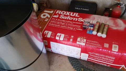

.......so I think I'm going to try and do the block off plate.....first step it's to clean out the fire box.......I'll post progress.....Thanks for the encouragement.......
I just installed a friends and did the block off plate and insulated the sides and back of the fireplace with roxul, it puts out some nice heat right away. If i were you i would make the blockoff plate b4 hand and cut a hole bigger where you think it will sit. You should be able to get the measurments where the outlet on the stove will be. Make a cardboard templet of the top of the stove with the outlet hole.

Thanks Cableman.....yes I'm going to make the plate, drill the holes, and precut the insulation into approximate chunks.
I know exactly where the hole should be. How much bigger would you cut it? Did you use silicone around the edge of the block off plate?

Ready to start the block off plate. Hope this is worth the extra effort.....
