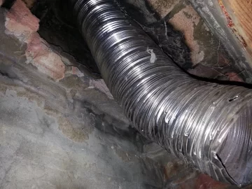

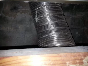

Hi we have just had a back boiler removed and there is an existing 6" flexible flue liner in place already
my question is this suitable for a new multi-fuel stove ??
the flue liner looks exactly like the current flue liners needed for the new stoves
any advise would be greatly appreciated

Greetings Antony. This is a case where there is no substitution for eyes on site. If the liner is stainless steel it might be qualified for multifuel use, but you want to be careful. If the boiler was gas it may not be. I would have a qualified sweep clean out the liner and certify that it is multifuel ready.
HI thanks for the quick reply , i will certainly get it checked out properly .
I've added 2 photos
thanks

It will need to be stailess steel grade 316 or 904 for multifuel. Impossible to tell if it is from pics. Most people in the UK use twinwall flex liner for multi-fuel these days.
