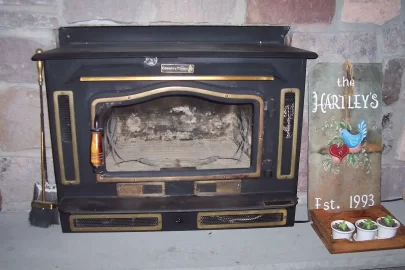

I am building a new home and have baulked at the cost of a masonary chimney.
My wife and I already have a Country Flame BBF woodburning insert that has traveled with us from house to house and we would like to use it again if possible. The local (upstate SC) fireplace store has stated that a zero clearence firebox would be a better option. My problem is that I have already paid some good $$$$ for the insert I have and like and am annoyed that I am being steered into effectivley repurchasing a similiar product. Could anybody provide some guidence.
Thank You
That stove was designed to be used as either an insert or free standing stove. Just gonna need to get some legs for it.
That thing is a beast.
These guys sell a set of legs for fifty bucks.
(broken link removed to https://www.americanenergysystems.com/cftqueenannlegs.cfm)
Thanks for the reply BrotherBart! I have been very pleased with its performance. I am down with turning it into a freestanding unit, and was unaware that it just needed legs, I thought that was a different model all together.

Here is what that bad boy looks like on legs.

That something is a masonry fireplace, at the tune of nearly $20K I'm guessing. It ain't going into a zero clearance fireplace is my bet!
Yeah a 580 pound 3.9cf cat stove made out of 5/16" and 1/4" plate. Sit that sucker on legs out in the living space, start a fire and you ain't gonna believe what happens next.

From what I read, the clearance requirements are 8 inches to the sides and back, 18 inches in the front.

The walls are just studs at this point. we would like to stick it as deep into the corner as we can, so unless I am seriously misinterpreting the install instructions I need so stick something fireproof like brick or rock or something with a 1" air gap to get my minimum distance down to either 6 or 12 feet.

According to the manual ((broken link removed to http://www.americanenergysystems.com/Stock/LibraryFiles/CatalyticV72rev15-26-091.pdf), 2009 version) reductions under 12" are not allowed. So the closest you can get it to the wall is 12" from the back corner when a ventilated heat shield is used. This link may be helpful: https://www.hearth.com/econtent/index.php/articles/stove_wall_clear
You also won't get around of seeing some pipe as you will need to keep some minimum clearance above the stove to the ceiling. The only one they are giving is for their R model in an alcove installation (page 17 bottom) which is at 42". For the BFF you probably need more as it is not even approved for an alcove installation. You may need to ask the manufacturer for how much.
