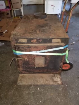

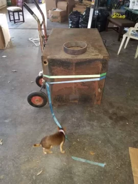

Not sure i didnt mean to post to the old wood furnace ill post pictures of it in a momentThere are two identical threads going on this. One here and one in the Classics.
@dogdog130 please clarify what you want to use. Is this a old wood furnace or a wood stove? What make and model?
Ok one of us will delete the other threadNot sure i didnt mean to post to the old wood furnace ill post pictures of it in a moment
Sent from my SM-N960U using Tapatalk

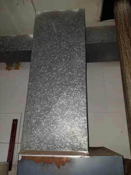

Ok that looks like a boiler not a hot air furnace. You really can't hook it into an air distribution system

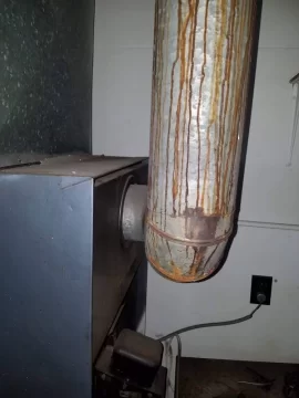

The boiler is the thing the op is calling a stoveUmmmm. I'm seeing a fan for forced air peeking out from under the sheet metal. Boilers don't have those.

How is it a boilerThe boiler is the thing the op is calling a stove
The holes at the back of the stove allowed cool water to enter at the lower hole and because hot water rises it leaves through the higher hole , probably a gravity system ( boilers are designed to keep heat inside , open the stove and take some pics of the inside . I’m not trying to pick on your post at all just trying to save you frustration . This will not be able to heat the plenum of the oil burner you would need to shut the blower off every few minutes or you’ll be blowing cold air .How is it a boiler

Umm yeah it's a oil hot air furnace and a wood boiler.Ummmm. I'm seeing a fan for forced air peeking out from under the sheet metal. Boilers don't have those.
