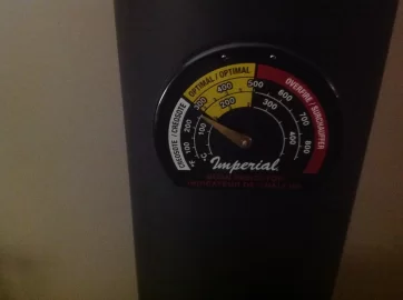

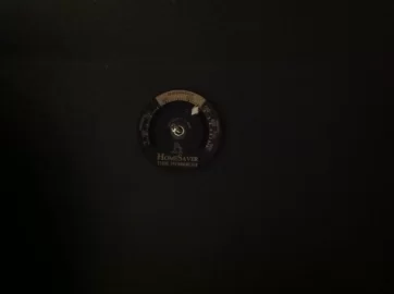

Thank you for the info. I have a stove pipe thermometer 18" up from stove as well as one on my stove. The one on my stove discolored slightly and the one on the pipe rarely reads above 300 in the creosote free zone. Even when the stove has been cranking at 450+ for 2 or 3 hours. Concerning?
There is nothing cranking at 450. This is a plate steel stove and 450 is just barely warmed up. At 700 it is cranking. I find that the NC30 needs to be shut down pretty soon to say 75% throttle to speed up the warm up and then generally only shut to 25% when draft is strong. It is not expected that you will be to run with a closed draft.
Wet wood blues. Split it smaller, stack it looser in the stove, and feed it more air to keep a relatively clean burn and make some heat. You can burn it, it will work, but not as well as dry wood.
Reactions: pen
I was under the impression that because I am new to burning wood, and my fuel is not the best I should having small to medium fires and feed it more often. The thermometer on my stove shows 450-550 as optimal, is this wrong? My stove seems to always settle around those temps when I air down to 1/2.
If your thermometer has Rutland written on it, there's a lot of wrong there. Their scale is a compromise between what is appropriate for a stove top and a stove pipe. Not only does that characteristic about them bother me, but that I had 2 or 3 of them die in short order, makes me never give them a second look.
I have several condars now, each 3 or 4 years old or so, and still work great.
Here's a better scale for stove pipe and stove top, respectively.
[Hearth.com] On The 8th day the damper has my # [Hearth.com] On The 8th day the damper has my #
These are my two thermometers. [Hearth.com] On The 8th day the damper has my #[Hearth.com] On The 8th day the damper has my #
In real time
