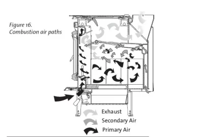

Did you cover up the secondary air inlet or was this the primary control you were talking about closing?
Congrats glad it worked out.
Um.... thought the primary was unrestricted and the knob/slider on the front controlled secondary air....
@bluedogz: The primary air is the one you control with the lever/slider. The secondary air is the constantly open inlet at the back of the stove that provides the air for the burn tubes, once things get blazing. Here is a diagram from the manual of my stove. This will give you the basic idea of how all the modern EPA stoves work.
[Hearth.com] One more first...
Primary air is controlled by you secondary air is controlled the draw of your chimney.

Oh, and yeah, I shut down primary air. Mea culpa... shoulda RTFM.
