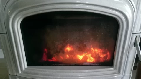

Some of you may recall a question I had about the earth's rotation affecting the burning of our stoves. My dealer had stated that just as toilet bowls flush in one direction in the Northern Hemisphere (and the opposite in the Southern), our stoves won't burn evenly depending on which way they're facing. He said, "if it backs up to the south or east" it won't burn evenly. I didn't know what to say to that. ?
So my dealer was once again in my house for another reason and said the same thing when I asked him about my stove not burning wood down one side as quickly as the other.
As you can see in this photo from this morning when I was burning down my coals, the latch side is alive with flames over the coals. The hinge side is black, behind a black glass, seemingly getting no air? I don't get it...

Earth rotation . . . just a dumb firefighter . . . but I suspect the reason why a stove may burn better on one side or another or why one side of the glass is black might have more to do with the stove construction, air flow and/or gasketing.
Both stoves I've burned (quad 3100 and Ideal Steel) have been cooler on the fresh air inlet side. Just my observation but I believe the air cools the stove down on the corresponding side and makes the burn a little less efficient causing black spots on glass and blackened fire brick on that side.

Check the holes above the side that is turning black. They may be plugged preventing the smoke from going out them.;) I just saw a video where a guy "FIXED" this problem by cutting 3" off his firebricks.
My guess is most stove doors are going to be designed for right handed people and therefore would have the hinge on the left. Gasket leakage is most likely more on the handle side of the door so there could be a subtle effect to combustion where slight air leakage on the right side of the door would cause slightly more combustion on the handle (right) side. Definitely don't think the coriolis effect is a factor

The Coriolis effect is real, but is swamped the the myriad of other forces and reactions happening in a wood stove. If it has any bearing on how your stove behaves, it is almost certainly immeasurably small.
My "educated" guess is that the reason the latch side is hotter is because the air is being drawn in on that side so them there coals along that side would get hotter faster. Of course that would depend on which way the air swirled inside the stove and at what velocity it was moving and whether it raining or snowing the day you took the picture
