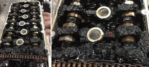

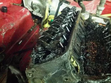

I fully agree. I did the timing chains on my 97 Ford Explorer at 205,000 (in 2008) and valve cover gaskets on my 03 Suburban at 215,000 (this summer) and there was zero sludge in either of those motors. Each had regular synthetic oil changes. Helped my BIL do a head gasket, timing chain, etc on his trailblazer and it was disgusting, but not quite as bad as the pics you showed. I know for a fact that truck wasn’t getting regular maintenance, and I’m pretty sure that’s why it was having the problems it that it was. I don’t think it had more than 120,00 on it.
@Ashful since I switched to synthetic 5w-40 for my diesel truck I starting that stuff in everything. All ope. For many years. Why use all these different weights. Rotella t6.
Reactions: aaronk25
i've got a 04 5.4 ford that ford wanted to use the 50/50 blend of oil and synt. it was burning a quart every 500 miles i changed to full synt and now have about 1500 miles and still haven't added any. and that's 5w20
