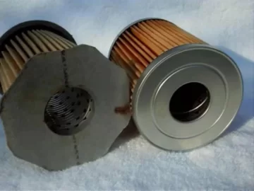

I’ve never understood the guy willing to spend $30 - $a50 on oil, while aiming to save $2 on a cheap filter. I figure it’s more just ignorance, than being cheap.
There’s a special SRT filter for my car, made by Wix. 67 pleats vs. Fram’s 32 pleats. Long-strand fiberglass vs. Fram’s cardboard. Silicone anti-drain back seal vs. Fram’s rubber. Coil spring valve vs. Fram’s stamped steel pan spring. No way in heck I’m dropping a Fram filter on anything I care about.
Fram on left, Wix on right.
True in my case. By chance I was curious about this this last night and watched a bunch of oil filter disassembly videos on Youtube,
Its seems that Fram and Motorcraft are on the low end and Wix/Napa are on the upper end. Purolator, which I've used until recently, fell somewhere in the middle.
I plan to invest in Wix/Napa filters in the future.
Edit: Looks like I can get the Napa Gold for my Tacoma for about $5 apiece on Ebay by the case -- an apparent no-brainer.
