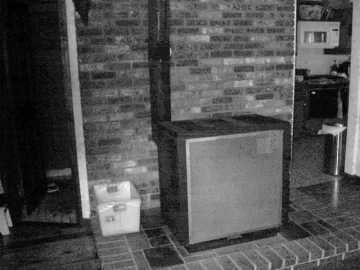

elkimmeg
Guest
A possible recipient of the donor program live in Norfolk MA. Those who know the area, near the former Airport. His current stove is vintage 70 convection heater, nothing fancy here a beige box. Located in the living room with an open stairway up and open hallway to the dinning room kitchen and out back a family room. The venting system consist of top venting single wall connector pipe to the proper ceiling flange and class A threw the second floor attic and out the roof. One issue that has to be addressed is the last 18” of single wall attaching to the flange has to have more clearance protection. We all know how hard it is to interface into older existing pipes. More info will be needed on that matter. One possible solution would be to install an outer pipe 8” creating a 1” airspace acting as a heat shield.
Realistically, the area is open, but no stove will heat the entire home. So far.. only Vermont Castings has agreed to participate in the donor program. so please address their stoves line. It does no good to suggest PE stoves, at this time as an option. If this program blossoms, I hope other manufactures will participate. It has to get successfully off the ground first. The emphasis has changed not so much stoves for the less fortunate, but stoves that replace old polluting beast of yesteryear, that the families normally cannot budget for.
The home is a two story colonial probably 2000 sq ft. First floor with rear family room 1000 -1200 sq ft. My original thoughts is a stove in the 40,000+ BTU range. Feeling any more would make, the existing living room unbearable to sit in. The brick hearth is setup ideal for right side loading door./ My thoughts is the Dutch west line
Opinions and discussion welcome
