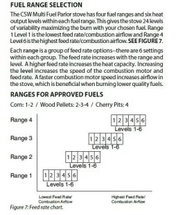

Burning stovechows. Bought 2 tons came to $376 after using the Lowes coupon from the post office that HD gladly accepts. They've been OK, but I have no experince with anything else. Here's the instructions:
[Hearth.com] Operating Questions
Nice chart to go by! That's a lot of adjustability and should serve you very well. So if your burning Chows on range 2 or 3 for example, and you buy something else of lower quality that needs more air, you could change to range 3 or 4 perhaps to make them burn better. Find some super premium pellets and you'll be able to burn in the lower ranges.
Wow.... I like that adjustability :)
Chart is pretty self explanatory. As J-takeman and Jrsdws describe, the better the fuel quality, the lower the program you can run. Some pellets require more air to ensure good combustion. Some require a higher feed rate to get the heat you want.
