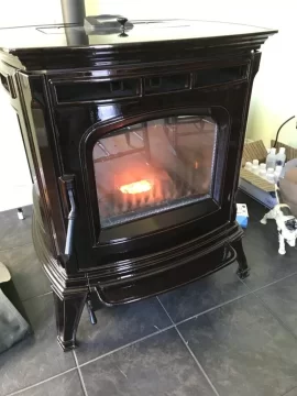

I have a new Harman Absolute63... this will be the first full season with it as I purchased and installed at the end of last season (March).
The way I have the schedule set up is the house drops back to 66 at night. The schedule dictates at 5:00 am bring the temp up to 74... so it likely runs full blast for an hour or so. (dunno... I am snoozing).
Then during the day it maintains 74 (we work from home) and has a very low flame going all day.
My question... will running the stove with a very low flame like this all day, every day, produce excess creosote or have any other detrimental effects?
Opinions valued.

Your Harman is one of the best designed units on the market. Run it like you want & if you clean it at the recommended intervals, you will be fine.
You won't get any creosote build-up. That is caused by burning wet, improperly seasoned cord wood. Wet pellets will not burn. They won't even remain pellets. They revert to wet sawdust.
Reactions: Orson_Yancey
