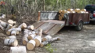

For a wood hauler & multi use trailer. 2 3500 lb dual axles would be nice for the extra weight capacity. A 7,000 trailer will haul a green cord of most wood types.

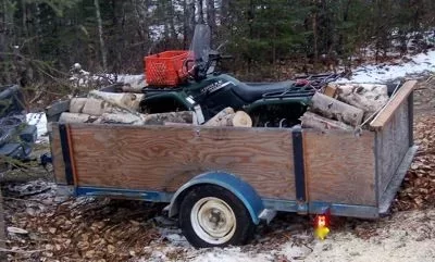

Mine is a single axle & easy to overload with wood, so am looking to upgrade to a dual axle ;)
Sides & a ramp tail gate are real nice features to have for a wood hauler too.

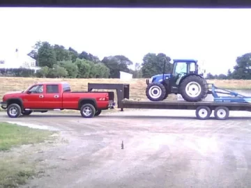

I don't know if this was directed at me or not, but my GN has 8 hole rims. The 2 axles are rated for 8,000lbs each. I haven't weighed it myself, but the gentleman that built it, said it was about 4500lbs empty. I'll figure 5,000lbs to be safe. The beams are a little thinner, but taller than what you typically see on GN's. He used a lighter weight beam, but was able to keep the strength in it. So basically I can put 11,000lbs on it for a payload. But because it's a custom trailer there is no "stamp" on it signifying that it's a 16,000lb trailer.

This is the unit. Plan on painting it this winter and put the reflective tape on it. getting it all legal. When i had the brakes done it also needed a battery with a safety disconnect on it.
Tell you how bad my memory is, i actually had 4 new rims put on it. But they weren't a bad price(for local), $70 a piece. It was one of those deals where it needed a few more things than i planned.
