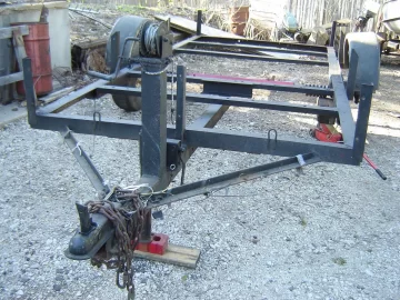

Got this trailer for FREE! It's 12' x 6' w/15" tires, looking for opinions as for decking that can handle rounds and put ( 2) ATV on. The rotted plywood was removed before taking the frame home.

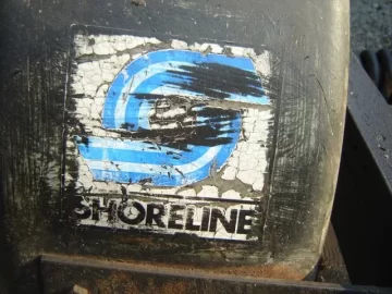

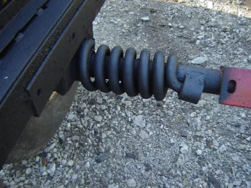

Title info is homemade trailer at 3000lb but i bet it can handle more( In IL 3k or less $18 a year to plate/tag). Its axle has torsion springs, I have no idea as to it carrying capacity, looks beefy. The fenders say Shoreline so it maybe a converted boat trailer. Anyone got info as to carrying capacity?

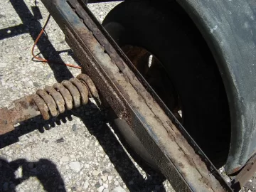

IMO I would probably use 5/4 x6 pressure treated decking. If it was heavier duty I would use 2x6 pt. I would definetely take the opportunity to get some por 15 paint and paint the rusted areas before putting on the deck. Just wire brush the rust, use the spray cleaner, paint with por 15 then coat with rattle can paint to block uv rays.

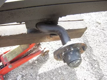

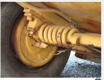

Torsion axle using a coil spring.
Horse & water trailers used them. Comfortable riding suspension.
Not sure anyone makes them now, the rubber torsion axle took over
3000# looks about right. that includes the weight of the trailer.
You'll find out if you get 1/2 a cord of green wood on & it bottoms out .
When you get a chance, load it up & keep an eye on the axle & spring.
Pic of one on (I think) an old military water/fuel tank :
[Hearth.com] Scrounging Trailer
Reactions: oppirs
Outstanding BogyD, You have found what I couldn't find online! It's just what this trailer got. I'm amazed what you folks know.

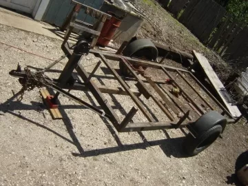

As you may have saw the frame is getting a treatment of undercoating/ new paint. I'll add pix as it is completed.

3000 lbs is where most states start to require brakes. Since that trailer has none, I expect that is the load capacity of that axle. Maybe. And yes, that includes the weight of the trailer.
You have a lot of overhang behind the axle. Be careful loading it, and keep more weight to the front so you have adequate tongue weight. Otherwise it will likely sway, alot.
I'm no fabricator, but I don't like the way it is constructed. Lot of things I would do differently. I'd start small, and see how it goes. I definitely wouldn't toss a green cord on it and take off.

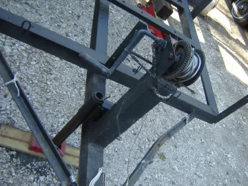

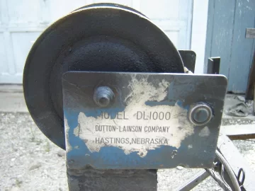

Winch is going to pay off 10fold........Just moved a 700 lb table saw one person job.
Reactions: oppirs
Funny Smokinj, sanding near the winch. Here ya go a pix, American made, love it! Yes it will come in handy.
Gonna paint it back to original or as close to possible with my unused cans of Ford blue. (Ford sold)

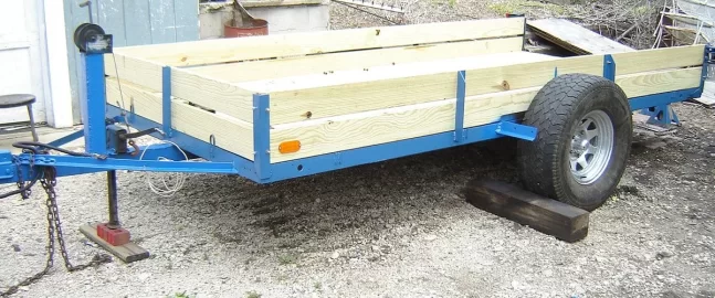

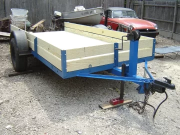

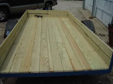

Added a bit of weight to this trailer. With 5/6 decking. 1 " move off the spring indent. Need to work on the tires. Bearings look well greased, I'll add more to those bearings.

Ya, but if he loads it to the top of the sides he has , It will be fine
Looking great ,by the way
Suppose you mean 5/4 decking?
I'll be yank'n logs via winch. Enjoy the pretty pics before the deck is beaten.
Looks perfect to me!
Thx all

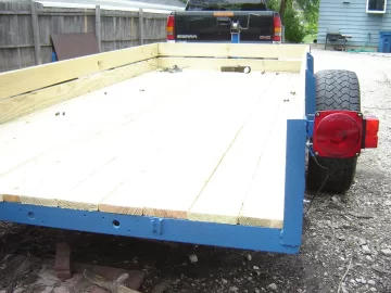

add finished trailer. Rims look seem like chrome, or a finish.
We want pics of it loaded,;) or it didn't happen!;)

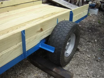

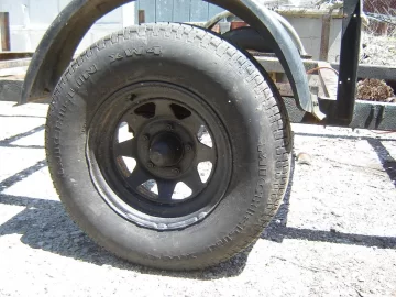

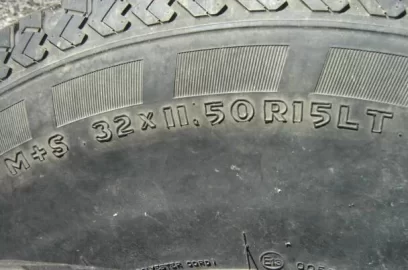

You all luv updates. Original fenders too narrow for these tires, removed fenders, Tires 12" wide but better in some of the muddy areas I will go and (free Tires) on top if it.
Anyone make fenders out of plastic barrels? Hwy or city's regulations really need fenders or I'd run them naked, but I'll need sumthing. Any advise?

If the old one's fit, leave them on.
I'll add pic as it rolls down the road.
If U R going to the trouble to make new fenders, instead U could use the old ones, flatten the outer edges, or cut off the outer edges and rework them, or just cut lips off and re paint
