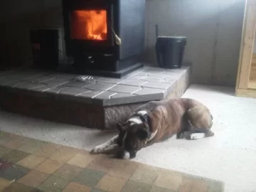

We like our raised hearth..Makes it easier to see inside the stove when reloading.I am glad we went with a raised hearth, At just 10 inches high, I couldn't imagine having to get any lower when loading. Our is ooffset about 6inches on one side to make more room for the kindling bucket and what not. [Hearth.com] Opinions on raised hearth.[Hearth.com] Opinions on raised hearth.

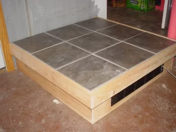

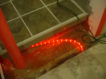

I have built two raised hearths. I luv them! They both have an overhang for rope light install and also I can get close for cleaning without the old Toe Jams!

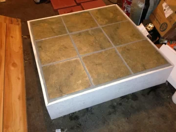

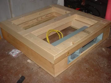

I put an Electric 220 Volt 900 Watt kickSpace heater with wall thermostat in my raised hearth. So I could keep my feet warm when the stove was down for cleaning! Then I made an overhang with a recessed 1/2" inch slot and installed rope light!! It cost me $600 with the tiled back and mantle! I wonder how much if I paid someone else!!! LOL See pics below!
P.S. Also made it to hold 9 - 12" x 12" tiles so no tile cutting LOL
Second one

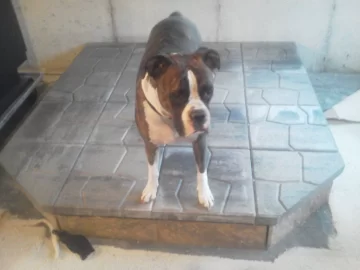

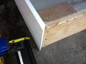

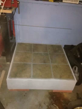

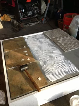

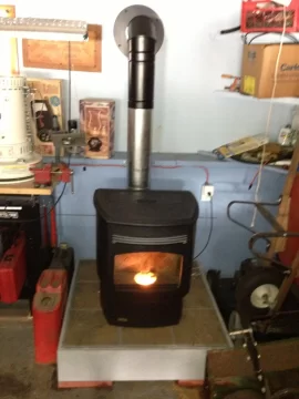

I just built my 3rd raised water proof hearth for the garage. Nice to have it warm to work on stuff in there!
The hearth has pressure treated 2x6s trimmed out with PVC board with the ruff side showing.
Then plywood, cement board and porcelain tile on top. Took time to build but really protects the stove from having all kinds of stuff too close to it!
Also put 4 red patio blocks under each corner to keep the hearth out of the puddle that always pools there!
Then I installed the Selkirk DT up & out kit and the garage is nice and cozy!

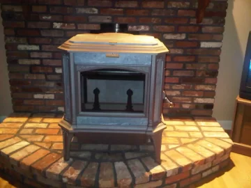

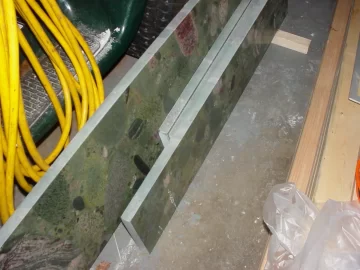

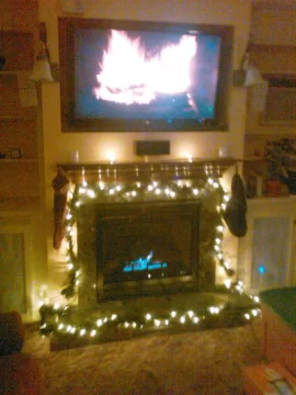

Just an ugly red brick raised hearth fireplace. Everytime I see you guys nice looking hearths here I go and throw another empty beer can at mine.

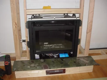

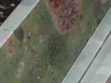

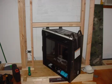

Red raised brick is not ugly. I could not afford a brick layer when I built my raised fireplace hearth. We had to settle for some granite remnants that we were lucky to find. They also cut them and polished them to fit.
