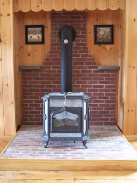

Kept it simple..6 inches high..

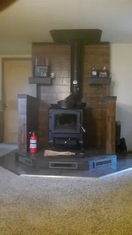

Do it. My raised hearth is a blessing both for loading with my crapped out knees and ankles and also re-burn stoves throw a ton of heat down and out from the glass. The more distance to the floor in front of it the better.
Is THAT the reason for the high floor R value on the 30 NC?
My hearth is raised about 16" to save bending over. My dog's favorite winter resting place is smack dab in front of the stove. I suppose she is technically combustible but she won't listen when we tell her to move.
