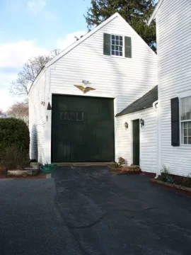

So I just measured the barn. It's 24' x 24' x 9', and then the loft.
There is siding on the barn, so you can't see through the walls.
I've attached a couple of pics.

Woodstoves, pelletstoves, indoor boilers, existing gas furnace/boiler . . . all are viable options . . . but I think you may be jumping the gun a bit . . . just a bit though. I think (as others have mentioned) that the very first step would be to button up the barn if you hope to use this as living space in the future. Insulation. Insulation. Insulation. As to how to insulate . . . there are options besides just laying up the fiberglass bats . . . spray on foam, cellulose between walls, foam boards, etc.
The next step I would think would be to think exactly how you want to lay out the place and what you plan to do there and how often you think will use the space. For example, if you think you'll use the space on a regular basis for virtual golf, perhaps using the space also as a media room or family area it might make sense to have a woodstove as a focal point. If, on the otherhand, you want to use the barn to occasionally do some virtual golfing and park your car it would not make sense (and could violate codes) to have a woodstove in the barn and in this case perhaps just running another line from the existing heating system (along with a thermostat set fairly low) would make more sense.
If you want to keep that interior barn look and feel, you might want to consider ripping the siding off and adding a layer of polyiso or polystyrene over the top of a dark paper (or other substrate, just so it looks good on the inside where you can see through the wood planks) and then siding back over that. Even a R5 1/2 layer of polyiso on the exterior would go a long way towards making that space livable. Obviously you'll want to insulate the top as well...
