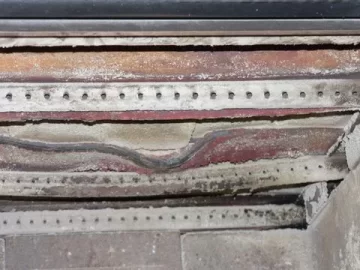

    The baffle is so badly warped in the middle the firebrick are sagging. The air tubes also look pretty bad.
    The installing company wants $ 500.00 just for the parts. They told be the manufacturer said the only way these would fail was from over firing. That is not the case. It occasionally reaches 600 to 650 degrees but that is for a very short time. I don't want to use this insert until the parts are replaced. I thought all of the metal had a lifetime warranty. Parts are ordered because I want to use it this winter. The metal warping didn't happen until last winter. I was told I can keep this insert fired up as long as I want and that is what I do. Does anybody else have any of these problems with any of your inserts.

    It almost looks like there was an air leak in that area that caused overheating. Contact fyrebug, he may be able to help you out here.

    I have contacted Osburn and they have told me to remove the firebrick on top and replace with 2 C - cast baffles. He told me this is how the new inserts are being manufactured. I have checked the thermometer, it is accurate.

    Hi guys, your stainless steel tubes are also drooping which indicates overfiring. As you may know, steel begins degrading & delaminating around 1,200f. If you reached 650f at the front of the insert that's a pretty good indication it was much hotter inside.
    An overdraft situation can occur if you have a very long chimney, your wood is exceptionally dry and if your gasket is leaking.
    What is the overall length of your chimney? Is it lined and what is the diameter of your liner? Is you liner insulated? Is your chimney inside or outside? Have you burned treated wood or compressed wood logs?
    PM me your serial number and i'll check how your claim is processing. I just want to make sure you have all the parts to fix this.

    Osburn tells me to remove the firebrick and put in 2 c cast baffles. Is this correct ? By the way I am a mason contractor that has been in business since 1976. Serial number is 018661

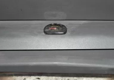

    I picked up the Osburn 2000 insert this summer and I already have my thermometer in the same spot as you. Im going to hit the stove top with the laser gun to see how accurate the magnetic thermometer is.

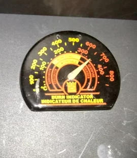

    I've owned 3 rutlands. And in my experience, each one read OK up until about 400 degrees, then their accuracy would drop off like a rock.
    Also, with an insert, you have to remember that the given location may not necessarily be the hottest spot of the stove.

    So who makes an accurate magnetic thermometer? Or what would you use?

    And I have used many brands of magnetic temp gauges - they behave just as someone else said- they are seriously 'off' once over 500-550.
    I have hit my stoves (coal and wood) with the Centech and while the mag temp gauge said 650 the centech read well over 700.
    My opinion - if that stove is built like the Century with the upper steel surface - then air gap - then steel jacket around stove - then it was way overfired if you had ever reached 650F using the mag gauge.
    To answer your other question ? Which magnetic temp gauge to use ? Many of them I've tried are decent up to 500-550. But I would not use a stove as much as you do without the $20 Centech IR Temp guns.

    I've had good luck with the condar line.

    I will check the one i have when i get home from work, I think it is a Condar, its black and gold. I do have a laser heat gun, and I will do a comparison with pics to see how they both read.

    With my 2000 the air gap is actually ontop of the stove top plate the magnetic thermometer is located, so the thermometer gets hot air blown on it. So if I aim at the stove top ill be good because thats what the magnet and laser will read. . Ill post picks tonight after work. If you look at the pic earlier in the thread of the thermometer on his stove top, mine is in the same location the difference is my hot air comes out between the surround and the stove top plate.

    Looking forward to pics - after looking at googled pics more closely - I see the air gap is on top of the top plate - but I'm willing to bet a soda that top plate is not the top plate of the stove combustion chamber. I'm betting there is "room" air below and some space - say an inch that seperates the top plate and the stove itself. Maybe Fyerbug can confirm.
    I suspect if there is any air gap - any reading of temps will not be a one to one comparison with someone operating a differently designed stove.

    On my insert, I can look into the gap and see the stove top. It's hard to get the IR gun aimed there, but do-able. I know, on mine, that it's the right spot because I've seen it glow red once. <eek>
    pen likes this.

    I have the Osburn 2400 insert. The stove top is the stove top as far as I understand. The jacket that creates the duct for the fan to blow the hot air terminates 9" or so from the front of the stove. I regularly get this unit above 650*. Etiger did a test with his ir gun and his stove top thermometer. They seemed to be reading pretty much the same temps. Magnet vs Laser thermometer
