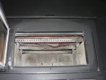

The baffle is so badly warped in the middle the firebrick are sagging. The air tubes also look pretty bad.
The installing company wants $ 500.00 just for the parts. They told be the manufacturer said the only way these would fail was from over firing. That is not the case. It occasionally reaches 600 to 650 degrees but that is for a very short time. I don't want to use this insert until the parts are replaced. I thought all of the metal had a lifetime warranty. Parts are ordered because I want to use it this winter. The metal warping didn't happen until last winter. I was told I can keep this insert fired up as long as I want and that is what I do. Does anybody else have any of these problems with any of your inserts.

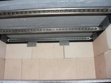

First of all I would like to thank FyreBug for his help in getting this claim processed. I had the new parts installed by the company that put in the two inserts. They told me they were not covered under warranty. Bill was $ 800.00 +

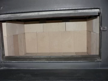

FyreBug gave me the direct contact for SBI which is where the parts for my insert came from. The firebrick were replaced with 2 c baffles on the top which is how the new Osburn inserts are being built. SBI processed a claim through the installing dealer
after I forwarded the claim number to them. It took about 2 months, but I received a check for $ 500.00 + from the installing dealer after they received a check from SBI. I will make sure I come back to this site in the future if I need any more help or have questions with these inserts. I am checking the temperatures carefully and don't expect to have problems in the future.

Yes, I am impressed. Attached is a couple of before and after pictures so everyone can see the new configuration. Thanks!

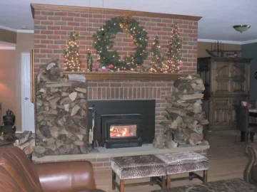

Below is the insert keeping us warm................Thanks!
