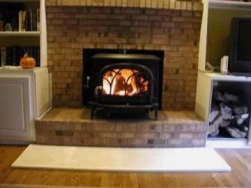

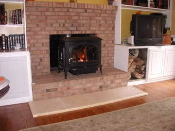

Shari,
I got your message and I will try to post pictures tonight. I have a similar installation. Stove sits on the hearth out in front of the fire place with only a inch or two of hearth. Hearth is 12" above the hard wood. I made a 62" x 18" hearth extension out of 3/4" plywood and four 18" x 18" ceramic tile. I attached trim around the three sides that face the room. It does not have the extra R value of durarock, but it does not get exposed to significant temps. So it basically serves as ember protection. I do all my loading through the side door and have not add any embers actually get out on the extension. I went with the 62" because it basically matches up with the width of the hearth.
The ceramic tile are not grouted or cemented to the plywood as this was a prototype that I was testing. I have a crack in one of the tile, I think from dropping a split or tool on it. So I am considering going with slate, marble, or stone to get better durability. Besides this issue, the other issue is that it can be a tripping hazard because it sticks up above the wood floor by about 1.25". So far I have only stubbed my toe once, and I am pretty careful to either completely step on to the extension or not step onto it.
The more professional way is to cut out the hardwood floor and install the tile/stone so that it is flush with the hardwood. But the wife is not sure about permanently altering the floor and likes the idea of removing the hearth extension from April to October. So we have what we have.
Congrats on your new purchase, I know the excitement. One other thing that I did is to insulate and put a heat shield in the back of my exterior masonry fireplace. I am glad I did as I am amazed at how hot it gets behind the stove, ie 175 - 200 F. No sense letting that heat go through the bricks. We use a small circulating fan to blow air behind the stove back out into the room.
We are loving our Oslo, but as many warned me, they love dry, well seasoned wood. Some of my wood was marginal 22 -25% mc this year. I already have 3 cords semi seasoned wood for next year so I learned the importance of dry wood. When it is dry, it is much easier.
Here are the pictures of my hearth extention made out of 3/4" plywood, (4) 18x18" ceramic tiles, trimmed on three sides. Overall dimensions are appr. 64" x 19"

GE,
Nice clean looking install! Thanks so much for the photos!
Shari
