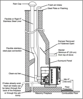

We have 3 inserts now, and i feel i need to get some outside air kits installed. I noticed this morning the heating vent in our bathroom was flowing cold air while the pellet stove was on so I think I'm pulling in outside air into the house making drafts. How do you run outside air kits in a chimney with no exterior wall? One stove is in the basement which means if I go all the way out I needa 25' outside air kit! Can I just run the OAK above my block off plate?

I would run the oak’s right up to the cap.

Duravent Prarie termination cap. The 3” oak pipe can be aluminum
What he said! Or run the duravent one piece pipe that the outer ring actually pulls down fresh air.

In regards to the original question, the best route would be up the chimney with another pipe beside the existing liner. There are caps made for this. I would never run appliances like these without outside air due to wasted heat as well as a safety hazard especially if there is draft vented gas appliances in the house.
You are correct, I can't go out a wall, the are interior chimneys. I'm going to use the 25' kit I bought to run up the chimney next up the liner.
