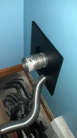

It's not even required to drill a second hole, just widen the exhaust hole a little & either modify the thimble or buy one that's already modified to allow the OAK to feed through the common opening.
[Hearth.com] Outside Air Kit - Oak - My research after investigating . I modified my thimble, but one can purchase a thimble that has the OAK
Reactions: Buckeyesfan75
