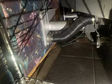

I gave up on the foil piping....ordered this and its a lot more durable...

Here is a pic of my set up, cost was about 17$ American

That appears to be vinyl or plastic tubing, if so that's really not to be used for the oak do to fire hazard.

The tubing I posted is acceptable, according to my insurance company, its used in an engine bay in cars that are high temperature and draws in outside air keeping it well below an ignition temperature....I've been using it for 2 years now without issue.
Mine ran for years using room air, then I measured intake and had local muffler pipe shop fix me a piece of exhaust steel tubing to fit and direct intake away from exhaust, a short piece of rubber tubing between pipe & stove works, used screw type clamps. I think tubing was originally for a gas fill in my old PU. Outside, I applied a good screen wire to end with a clamp, all painted black.
I used 2 sections of automotive flexible exhaust pipe. Joined in the middle and a through the wall with rigid exhaust pipe. Didn’t cost much.
