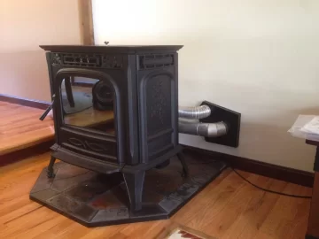

Agree.. don't take up much space either..OAK on the left in dead space area..
  • [Hearth.com] Outside air kits

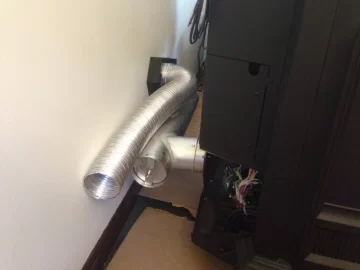

With the Englander I didn't have a choice but I rigged it up with about $40 of dryer vent stuff. Not exactly a wallet killer.
It's an ugly basement install so it's not being showcased in better homes and garden. Haha
It surely will. I'm finishing the hookup tonight. Pics will be coming.
