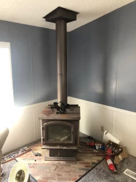

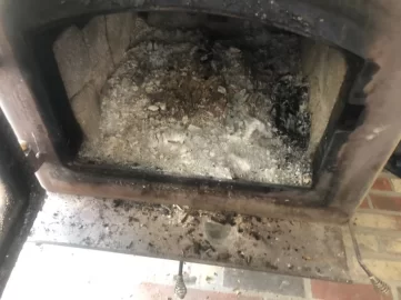

What does the label say is the model of the stove? Can you post some pictures of both the stove interior and the label on the rear?
[Hearth.com] Outside air supply for Manufactured Home Installation [Hearth.com] Outside air supply for Manufactured Home Installation [Hearth.com] Outside air supply for Manufactured Home Installation [Hearth.com] Outside air supply for Manufactured Home Installation [Hearth.com] Outside air supply for Manufactured Home Installation
I apologize for it being dirty need to remove the ash. This is the shape it was in when I bought the home
It's old but still a reasonably modern stove and a decent sized one too. It can have an outside air supply connected. Actually, that should have been done when it was installed. Is the air deflector in the front top bent or sagging?
Like webby said, partially seasoned wood can lead to poor performance. So can a too short flue system for some stoves. Also, it looks like the air ports at the back are plugged. Cleaned up and repainted you should be able to sell it for $250-300, especially in Sept/Oct.
A few questions for you: How many sq ft are you trying to heat with the stove? How tall is the flue system from stove top to chimney cap? How well seasoned is the wood supply?
I had a 1500 square foot modular home that we could heat super easy. Our Oslo, which looks comparably sized, would blow us out of there! We heated exclusively with wood and only used about 1.5 cords a season.
I believe it is bent at a downward angle by design, not sagging. My prefab home is a bit over 1500 sq ft. Honestly would be happy if it heated half of this space. As far as height to the chimney cap, 3-4 ft from above the ceiling. I bought a mixed cord(Im unsure of quality), but will but quality well seasoned wood for next season.
After hearing everyones input, I want to restore this one and give it a season. Am I missing anything.
- add outside air supply
- clean and repaint (aesthetics)
- other than cleaning, anything else I should so on the inside? Replace the ceramic blocks for example?
- During a heavy rain, a very little amount of water came down the flue and dripped on to the top of the stove from the inside inside of the flue. Should I replace my flue?
- you mentioned it looked like the air ports are plugged in the back, where are these? How can I unplug them?
Thank you guys so much for your guys help! I would be at a major loss had I not found this forum.
If there is only 10' of flue total then I would add a 4' section of chimney pipe. It will need to be braced at 5' above the roof. The rain dripping may be just the chimney cap design or it may be water traveled down the seam on the chimney pipe, If you can get a shot of the chimney and the chimney flashing that may help us to spot something.
The air ports are circled in red. They look like they may be full of ash. Hard to say from a photo, but worth checking. If they are full of ash, gently clean them out with a long thin screwdriver and vacuum. The piece that looks to be at an odd angle is marked with a blue line. Might just be the camera angle, but it looks odd.
