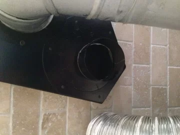

So... I feel a little stupid asking this question.. I have had my stove for two heating seasons now. I was cleaning around the stove today and saw that my OAK has numbers and adjusts.. _g.. Shows how observant I am.. I assume this is to adjust the amount of outside air draw.. How is it best to titrate this?

The install manual for the OAK thimble will tell you what to set it at, based on the stove you have.
I would leave it open full unless you are having an overfire situation.
It has been fully open since it was installed.. I am surprised.. But not surprised at the same time that the installer didn't mention it.. Good thing it was open!
