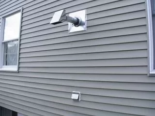

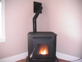

I'm not sure about it adding to the heat inside, that's possible. I just like the look on the outside of my home better. See pics.
