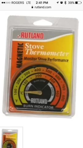

No that thermometer is meant to be put 18" up on a single wall stove pipe. Also correct me if I'm wrong but 500f should be in the burn zone on that thermometer.

Although the thermometer is meant for the flue and not the stovetop, the temp readings are still valid. Does this insert have a convection top or does it only convects out the sides? If convection top, 500F on the stove face could be the equivalent of 650F on the stove top.
The readings would be higher on stove top or face then 18" up on a single wall flue no???
Probably, but it is just a thermometer regardless of where it is being used. The scales on it are what are specific to use on the flue.
my point being that if you were reading 500 on stove top or face you could actually be reading on the lower end of the burn zone on your flue temps.
Yes, that's possible. Measuring flue temps for an insert is difficult in most cases without a remote probe or contact thermometer.
So there is some confusion about the thermometor. I was allowing for the error I found when I tested it in the oven. A 500 degree reading 8s at least 550 since it was reading 400 when set on 450 in the oven. The discrepancy seems to be larger the higher the temp.

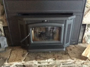

This, is entirely possible. I am going to update my super insert thread as I have been running a magnet thermometer on the 'face' right above the door and that thermometer has gone way into the to hot zone a lot of the time. Yet my chimney effectively plugged up enough to kill draft in about a month maybe six weeks of intermittent burning. I've now moved that same thermometer to the top of the stove and I can view it with a flashlight and I'm going to see where this thing is actually burning at. I was getting what looked like great secondaries off of the super and what seemed like lots of heat. Glass stayed super clean. I'm burning from the same pile in my downstairs summit and have zero creo issue in that chimney and the liner is uninsulated, vs a insulated liner on the insert. So wood is effectively ruled out.
I am no longer trusting 'face' temp readings. Espescially with stoves having a airwash to clean the glass with high temp I feel that monitoring my face temps has been misleading at best.
Just something to consider OP. I know it's an entirely different insert but if you can access your cap/chimney I would check it out.
Reactions: Redman2006
Here is where I was monitoring my temps, would soar over 500 a lot. Also shows the amount of build up I get on the glass.

I wouldn't leave the door open on a reload. You can probably get away with 1/2 air and closed door with a bed of hot coals.
I agree with the others, start shutting it down much, much earlier. If the problem persists, you may need a chimney pipe damper. Others may disagree, but 600 degrees should not hurt your stove. It's going to creak and pop because the different parts are expanding at different rates.
