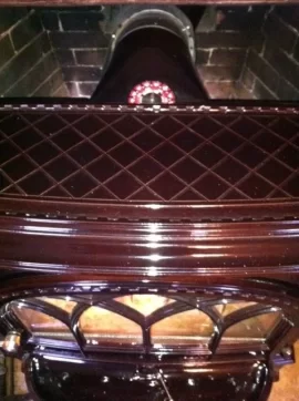

Good stuff, Pen. But now you've got me wondering about my own thermometer placement. I moved my Rutland thermometer off the top of my Jotul for aesthetic reasons and onto the pipe in the back. Is that OK, or do I need to adjust for it not sitting directly on the firebox?
  • [Hearth.com] overfiring?
Jotul shows placement in the manual on the cooktop. Maybe get a better looking thermometer?
LOL. It's not so much the thermometer itself as it is just having something on the top there.
Did an experiment this morning. I moved the thermometer to where the Jotul manual says to put it - on top of the actual firebox to one side. Started a fire and got it going up to just under 550 and let it cruise there for awhile. I then moved it back to where I had been keeping it - on the top rear near the vent pipe thingy. I waited 30 minutes and checked it, and there was no difference. So I think I'm going to keep it there. It might be slightly cooler there, but I think the difference is probably negligible.
